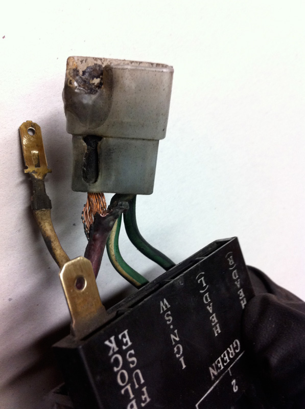

Well you were definitely right Kevin...
Fusible link is in need of some love
I'll post pics on Saturday but I was able to clean and salvage something...
Need to order more parts from Japan!

I took my old fusible links to an auto electrician and he made up new ones on the spot. Apparently the colour of the wire tells him what amp rating it is.
PostPosted: Sat May 12, 2012 1:55 am
Joined: Tue Dec 14, 2010 12:16 am
Posts: 48
Location: Adelaide South Australia
Spot on kev, it usually goes
Orange 3A
Green 5A
Brown 10A
Blue 15A
Red 20A
White 40A
Well, it used to anyway :)

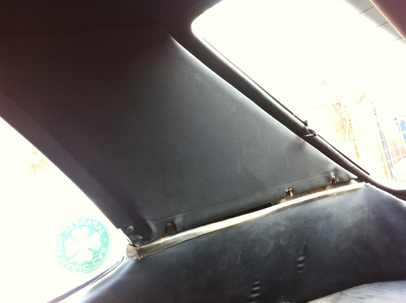

First, I owed you a pic of the C-pillar interior trim re-upholstered and back in the car. Here's a pic of driver side:

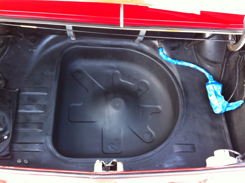

As mentioned last week, I repainted the trunk spare tire well:
Thanks to Kevin's pointing me in the right direction, I was able to track my odd lighting issue from last week down to this little jewel:
I pulled all the connectors, cleaned them as best I could with steel wool, added a dab of dielectric grease, found a matching Nissan 4pin connector, and put it all back together. Works fine now.

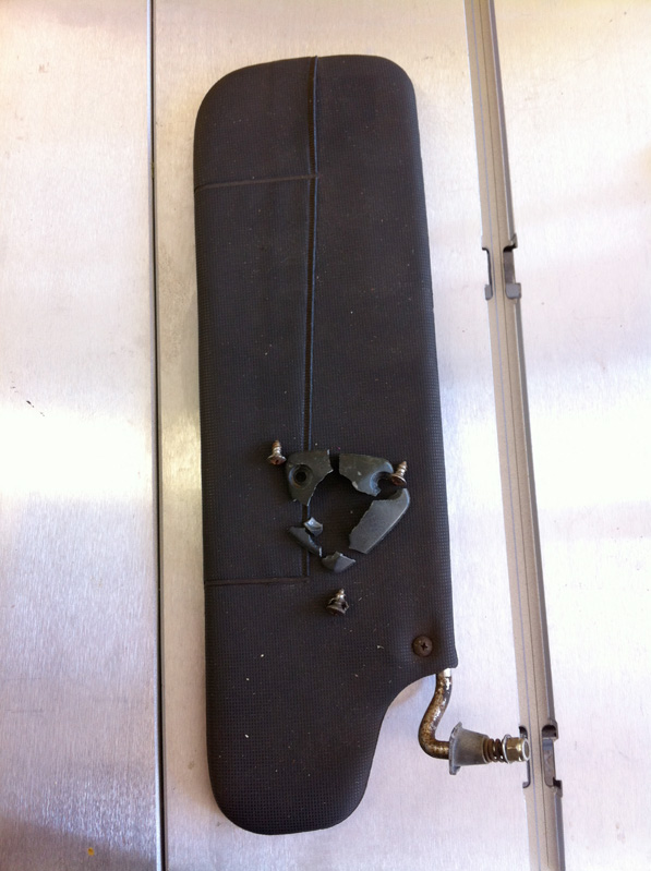

Unfortunately, I went to tighten a loose driver side sun visor, and the pot metal base shattered pretty completely...
Two steps forward, one step back... Will start looking for one driver side, or a pair of good sun visors...

I think you can fix that pot metal sunvisor thing. From memory, it's hollow, and you can "fill" the back of the piece with QBond powder, when it sets hard, it might hold it all together. You can build it up in layers, so that the QBond is quite thick.
One of the plastic bases on my fender mirrors cracked into three pieces, but because it too had a bit of a hollow in it, I filled it totally with QBond and it's held fine (touch wood) to this day :)

We have JB Weld over here Kevin - probably same product, different name...
I guess I can give it a try... I just wonder what kind of torque the rotating sunvisor arm is going to put on this fragile pieced-together part... I guess it's worth a shot since it can't break more...

PostPosted: Tue May 15, 2012 4:10 pm
QBond isn't quite the same as JB Weld, it's a powder, which sets hard when you sprinkle a few drops of this fluid onto it. So I was thinking...maybe you can slowly build up layers of the hardened powder, until you get this solid hockey puck of material in the hollow of the pot metal piece.
You could then fill and sand the front of it, and after a lick of paint (in the event that it doesn't revert to a million broken pieces again... :D) no one will be the wiser :)

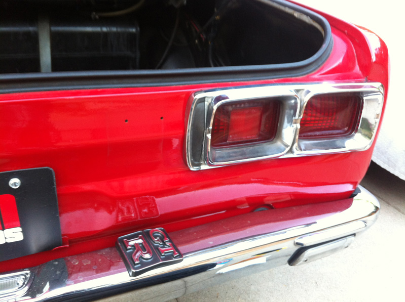

First off, to avoid any further confusion, the "GT-R" badge is now off the car. It had been double stick taped on - & actually wasn't quite centered over the mounting holes where it was supposed to be. I just heard that the badges I wanted off of YAJ are on their way to me now!
I think I've changed my mind 18 times about the "Wind" badges...
The mounting holes are clearly visible inside the trunk so it would be easy to get them in exactly the right place.
I just don't know if I want to pierce through the red paint or not...
Thoughts?

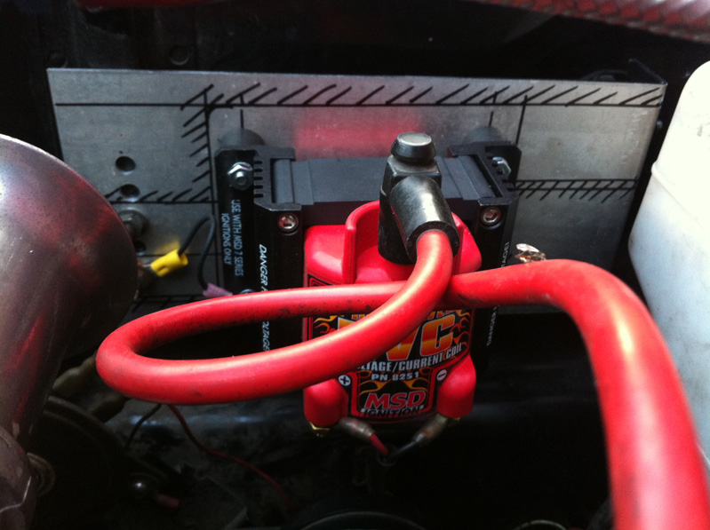

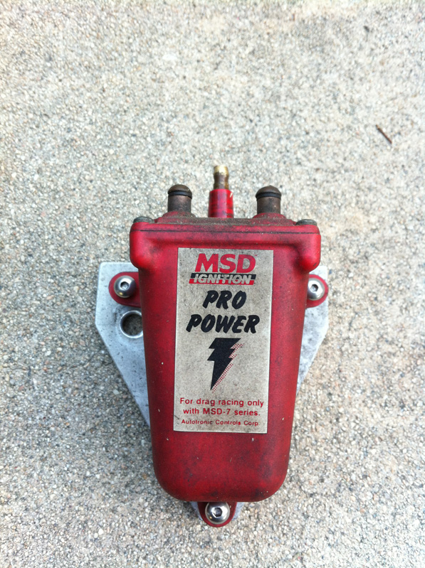

Here's the MSD coil that the previous Japanese owner fitted to the car. The coil terminal kept getting loose which led to some misfire issues so I pulled it off and replaced it. The bracket for it was actually really nicely made using factory bolt holes.
Also notice how it says "for drag racing only"? To be honest, I'm unsure how a coil could be application specific?
I decided to stay with the same ignition that the car came with, so I ordered up a new MSD coil (this time NOT drag racing specific), and test fit a new bracket for it.

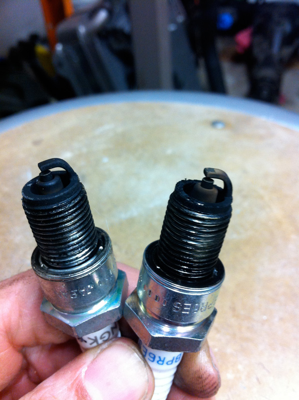

The car came with NGK BP7ES and they were running really black and sooty when I drove it down from SLC.
I swapped out to NGK BPR6ES and it looks better. This is the best pic I managed to snap. The insulator is mostly brown with slight spots of tan.
Does anyone think I should go one step hotter to BPR5ES?
PostPosted: Tue May 15, 2012 9:41 pm
Maybe the old coil cuts out if you go around a corner? :) I've never been a fan of those badges on the rear fender. They're nice, but not very "racecar" :lol:
Plugs look ok to me, but we should probably take a look at your jetting. IMHO, japanese jetting is usually a click or two richer than recommended.
